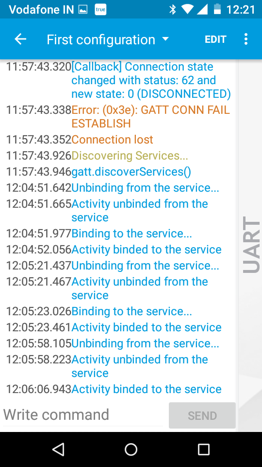

  • @Petter Is this issue still there?
    I am getting the following error in nRF Toolbox (UART) app
    image description
    My settings are the following
    #define SEC_PARAM_BOND                  0                                           /**< Perform bonding. */
    #define SEC_PARAM_MITM                  1                                           /**< Man In The Middle protection not required. */
    // #define SEC_PARAM_IO_CAPABILITIES       BLE_GAP_IO_CAPS_DISPLAY_ONLY                        /**< No I/O capabilities. */
    #define SEC_PARAM_IO_CAPABILITIES       BLE_GAP_IO_CAPS_DISPLAY_YESNO                        /**< No I/O capabilities. */
    #define SEC_PARAM_OOB                   0                                           /**< Out Of Band data not available. */
    #define SEC_PARAM_MIN_KEY_SIZE          7                                           /**< Minimum encryption key size. */
    #define SEC_PARAM_MAX_KEY_SIZE          16                                          /**< Maximum encryption key size. */
    #define START_STRING                    "Start...\n"                                /**< The string that will be sent over the UART when the application starts. */
    #define PASSKEY_TXT                     "Passkey:"                                  /**< Message to be displayed together with the pass-key. */
    #define PASSKEY_TXT_LENGTH              8                                           /**< Length of message to be displayed together with the pass-key. */
    #define PASSKEY_LENGTH                  6                                           /**< Length of pass-key received by the stack for display. */
    #define STATIC_PASSKEY					"123456" 									/**< Static pin. */
