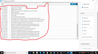

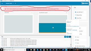

     I tried to flash the softdevice ,bootloder,application hex files by using nRF Connect ,softdevice hex is flashed successfully but when i tryed to flash the bootloader hex its showing some error please look the screen short.
    •  NOTE:- when i flashed the softdevice ,bootloder and application hex file with " nRFgo Studio " there is no error is showing and also the flashing is taking place successfully and the application working fine too.
    1.  Why that error is showing on nRF_ Connect?
    LOGGINGS SCREEN SHORT ARE PLACED BELOW

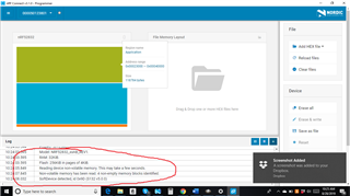

    Have you tried program using nRFgo Studio, close nRFgo Studio, open nRF Connect and Programmer plug-in and hit the Read button?
     I did these look the below screen short .
    LOOK THERE IS ONLY SOFTDEVICE AND APPLICATION SECTION IN THE MEMORY LAYOUT NO BOOLTODER SECTION. IN WHICH MEMORY THE BOOTLOADER IS STORING?
