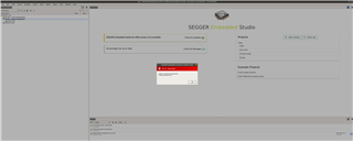

I've been having lots of issues putting the example projects on the NRF9160 dev kit.  It builds without errors, connects to J-Link, but sometimes fails on the download step.  Sometimes it works without any issues.  I select download Intel Hex file to the device and select merged.hex from the project I just built.  It will get to about 80% finished and give a "Failed to download application.  Undocumented error." error.  Then about 10-15 seconds later the Segger Embedded Studio crashes.  I am using SES v4.20a and it says there is an update available, but it tries to download the non-Nordic version.  Is it possible to not use the SES at all and just flash my device with firmare from the command line?  Is there a guide anywhere on how to do this?
