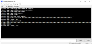

    The output is as follows. I put the NRF_LOG_INFO() commands right before the break. As it can be sen even if I send 244 bytes, RealTerm sends 2 chucks of 64 bytes (128 bytes is cumulative) and then stops. This explains why I have to send the 244 bytes twice.
    I believe it is because of the serial terminals. I have tried with serial terminals other than the mentioned above. The way they send is different but still not as wanted though. Our developer is working on the computer interface anyways, he will have to make sure that he handles transmission properly. Thanks for your suggestion.
