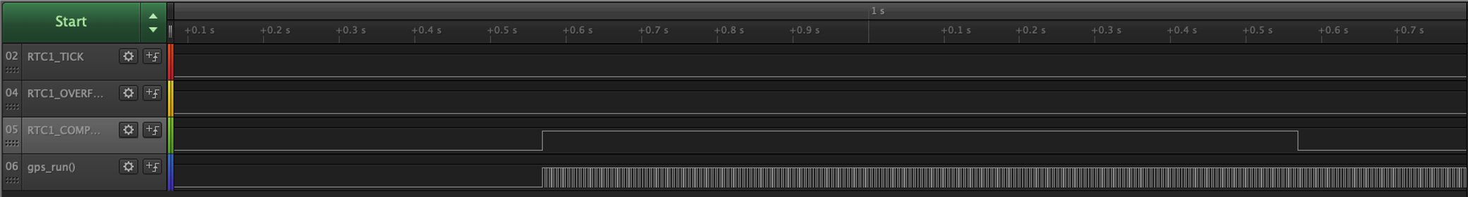

Main loop iterating too quickly. nrf_pwr_mgmt_run() returns in 1ms.
Hi. The main loop of my app is mostly doing SPI communication to a GPS receiver. I'd like it to do that every second or so and spend the rest of the time in system on but waiting for an event. I want nrf_pwr_mgmt_run() to block for about a second on each iteration of the main loop, so I create a repeated timer with 1 Hz frequency and a no-op handler. Instead I'm finding it returns very quickly every time - about every 1 ms.
Here's a fairly minimal test for my GPS receiver driver that reproduces the issue.

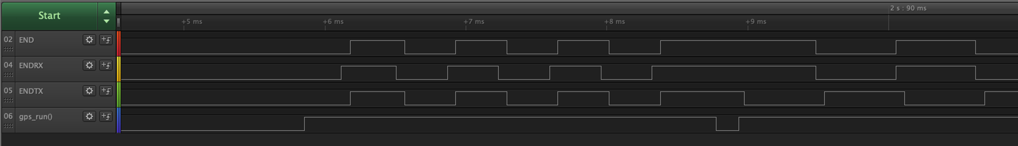

Although there are SPI comms happening here, I can run this on the PCA10040 DK board (that has no GPS receiver, obvs) and it will still run OK, it just doesn't get anything back on the SPI. The same timing issue happens on my own custom board.
How can I get a better idea of what event it was that caused nrf_pwr_mgmt_run() to return?

[Edit 2]
I turned the SAADC off. It helps, but isn't sufficient. I now have my main loop iterating once every 5ms or so, up from once every 1ms. I don't understand how or why.

    I hooked another logic analyser channel up and set it high at the start of my gps_run() function, low at the end. Here's what I saw.
    I had suspected that an SPI event was happening *after* the end of gps_run(), causing nrf_pwr_mgmt_run() to return and the main loop to iterate straight away. But the logic analyser shows no events happening in between executions of gps_run(). This leads me to conclude the event causing nrf_pwr_mgmt_run() to return is not an SPI event, but some other one. But keep in mind that the only peripherals I have enabled for this test are: SPIM2, RTC1, and GPIOTE.
    For the RTC1, you can see in the test code above I'm setting up a couple of timers. There are a few more in the GPS driver. They're all either single shot, or for the recurring ones the interval is at least APP_TIMER_TICKS(1000).

  • I hooked the PPI stuff up to check the following events:
    NRF_RTC1->EVENTS_TICK
    NRF_RTC1->EVENTS_OVRFLW
    NRF_RTC1->EVENTS_COMPARE[0]
    NRF_RTC1->EVENTS_COMPARE[1]
    NRF_RTC1->EVENTS_COMPARE[2]
    NRF_RTC1->EVENTS_COMPARE[3]
    NRF_GPIOTE->EVENTS_IN[0]
    NRF_GPIOTE->EVENTS_IN[1]
    NRF_GPIOTE->EVENTS_IN[2]
    NRF_GPIOTE->EVENTS_IN[3]
    NRF_GPIOTE->EVENTS_IN[4]
    NRF_GPIOTE->EVENTS_IN[5]
    NRF_GPIOTE->EVENTS_IN[6]
    NRF_GPIOTE->EVENTS_IN[7]
    Here's what I saw for the first three of them:
    Only the RTC1 compare event is happening and it's happening exactly as I would expect: once a second. (I'm actually a little confused as to why the TICK event *doesn't* fire, but it's good that it doesn't in my case so never mind that for now.)
    None of the other events fired at all.

  • That is strange. Have you ruled out if the SPIM peripheral is waking the chip up by itself, by replacing the call to gps_run() with toggling of a GPIO?
  • My goodness. With gps_run() commented out, the main loop toggles a GPIO every second.
    I'm wasn't sure how to reconcile that with my earlier PPI discovery that no SPI events are occurring outside the scope of gps_run().
