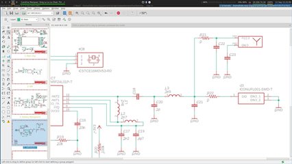

in my custom board I'm using an NRF24L01+ as RF transceiver. The relevant part of schematic follow: (hi res => https://imgur.com/a/z4nQxXh )
The following components value changed during tune phase:
  • c22=8,2pf RF
  • c23=4,0 RF
  • r21=0
  • r22= c20 c21=OPEN
  • L3= Short
  • C18= 47pf RF
I'm using M310210 as antenna (datasheet => https://media.digikey.com/pdf/Data%20Sheets/Ethertronics/M310210.pdf )
The result: (hi res => https://imgur.com/a/4ZdtaZ0 )
However I cannot exchange data between two boards. If I connect the boards to a reference NRF24L01+ boards the communication works. The chip soldered on the board communicate correctly with the CPU, since I can read back the configuration.
Am I missing something?

  • Alright, I did some test and found that the board I was using can correctly TX/RX on channel 76, meanwhile the other one must be set on channel 78 to receive the data sent by the one set on channel 76. Weird. I assembled another board and can correctly receive data on 76,  however I can't send. I will do some measurement on Monday, but at this point the antenna should be correctly matched.
    Gabriele
  • I wouldn't focus too much on the antenna here. A poor antenna will affect range, but not frequency. So I would rather have checked if you may have mounted the wrong component values on the load capacitors on the xtal or wrong decoupling capacitors etc.
