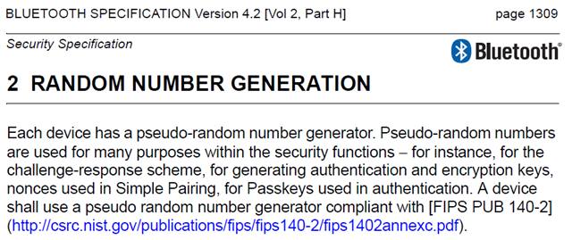

Hi. I'm using nRF52832, SDK13.0.0.
The roll is peripheral.
And I'm using Oberon to use ECDH.
I think you have the result or document for random generator's performance based on Shannon or NIST or DieHard tests.
Could you please let me know your result?
  • The RNG module is designed to meet the requirements in Bluetooth. The RNG has been tested in-house according to the NIST SP 800-22 statistical test suite. But it has not been certified by an external test house.
  • Thank you very much for your reply. As you mentioned, the RNG has been tested. So do you have any document or any result for this in-house test?
  • Thank you so much for your help. And I checked biad correction, it is enabled.
    But as I've tested with Dieharder, the result is not good as below.
