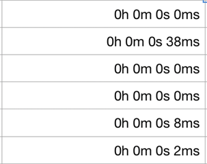

  • Measured by looking at how the offset between the SoC's and master's timestamps changes across multiple synchronizations (* Figure 1)

  • I send the timestamp from the SoC to the master multiple times, calculating the difference between their clocks' timestamp offsets to see if they are always the same, as they should be, since the clocks run independently in parallel
* Figure 1: Expected timestamp offset across synchronizations

  2. I've seen a random difference between the timestamp offsets for one device, which is sometimes within 20ms and sometimes seems to be multiples of the connection interval (up to 4 times 30ms)
    • Q2: What could be the cause of the smaller errors? I think that maybe the transmission window is the culprit here
      • Please note that the packages are being received with some milliseconds of difference between them, according to the data in the HCI Snoop Log (* Figure 2)
    • Q3: How could it be that some packages are being received a couple of connection events after I enqueued them if there seems to be enough space in the queue and I did not enqueue other packets?

    A2: The notifications are transmitted int the order there were transmitted. But if you also send other BLE data, there may be some other packets that were queued before, and if so, these will be transmitted before. This is the most likely explanation for variation within a connection event.
    A3: The most probable reason for seeing delays which are multiple of a connection interval is packet loss, which leads to retransmission the next connection event (and so on, until the packet is successfully transferred or there is a supervision timeout). It could also be that if you are transmitting a lot of data and/or the link does not support "enough" packets per connection event, the packet is delayed until the next event in this case as well.
