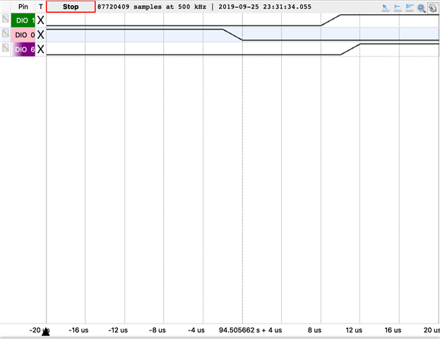

  • Hi Vidar,
    I have some test results and was able to capture this issue occurring while recording with a logic analyzer, the results are attached below.
    In the top row (DIO 1), a GPIO is being set during the ISR that sets our data ready flag.
    In the middle row (DIO 0) is the sensor's interrupt pin (active low).
    The bottom row (DIO 6) follows a GPIO that is being set on the first line inside this conditional where the sensor's interrupt pin is active but data ready flag hasn't been set yet.
    The latency between interrupt pin being active and ISR executing doesn't look concerning, it's around 8μs on average which seems like what we should be expecting.
    Do you see anything concerning here or does it seem like this is just a natural case of the processor completing its pipelined instructions before executing the ISR that we are hitting by coincidence some small % of the time?
    Thanks again!
    Thanks for the logic trace. It's interesting that the IRQ is asserted but the flag ist still read as zero afterward from main the context. The timing looks as expected at least.
    I think you can test the theory related to pipelined instructions by placing instruction barriers (__ISB()) and maybe __MSB for good measure.
    By the way, are you testing with or without compiler optimization, and is link-time optimization enabled? And could you verify if s_imu_data_ready is loaded from RAM in the conditional check?
