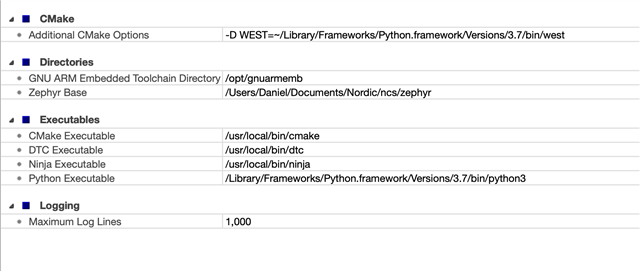

    /usr/local/bin/cmake -GNinja -DBOARD=nrf9160_pca10090ns -DBOARD_DIR=/Users/Daniel/Documents/Nordic/ncs/zephyr/boards/arm/nrf9160_pca10090 -DZEPHYR_TOOLCHAIN_VARIANT=gnuarmemb -DGNUARMEMB_TOOLCHAIN_PATH=/opt/gnuarmemb -B/Users/Daniel/Documents/Nordic/ncs/nrf/applications/asset_tracker/build_nrf9160_pca10090ns -H/Users/Daniel/Documents/Nordic/ncs/nrf/applications/asset_tracker -DPYTHON_EXECUTABLE=/Library/Frameworks/Python.framework/Versions/3.7/bin/python3 -DCMAKE_MAKE_PROGRAM=/usr/local/bin/ninja -DDTC=/usr/local/bin/dtc -D WEST=~/Library/Frameworks/Python.framework/Versions/3.7/bin/west -DEXTRA_KCONFIG_TARGETS=menuconfig_ses -DEXTRA_KCONFIG_TARGET_COMMAND_FOR_menuconfig_ses=/Users/Daniel/Documents/Nordic/arm_segger_embedded_studio_v420a_macos_x64_nordic/html/configure_nordic_project_menuconfig.py

    -- Found west: /Users/Daniel/Library/Frameworks/Python.framework/Versions/3.7/bin/west (found suitable version "", minimum required is "0.6.0")

      FileNotFoundError: [Errno 2] No such file or directory:
      '/Users/Daniel/Library/Frameworks/Python.framework/Versions/3.7/bin/west':

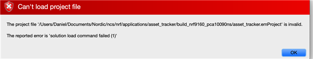

    Project load failed
    Reported error: solution load command failed (1)

    Project load failed
