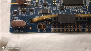

We are using nRF9160 DK, and we are working on ADC channel. we use This example of ADC.  I am using single-ended with no over-sampling with a gain of 1/6, reference 0.6.
10 bit ADC resolution. we want to find voltage given by power supply to nRF9160 like 1v, 1.5v, 2v but getting value is less than the input value
like I share some reading
Applied Voltage (mV) Raw Value(count) Displaying Voltage(mV)
1003 260 914
1500 400 1404
1999 540 1900
3001 612 2153
