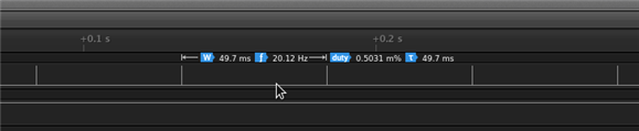

Why does toggling a GPIO pin happen in constant time, but not set and clear for GPIO?
In testing the timers on the dongle, I have made a GPIO pin be controlled by the timer triggering.
So the following has a constant time between edges:
    case NRF_TIMER_EVENT_COMPARE1:
        nrf_gpio_pin_toggle(DBG_TIMING_PIN_1); // This happens with a constant spacing between signal edges
While this does not:
        // This creates a small impulse, but the timing between these impulses vary
        nrf_gpio_pin_set(DBG_TIMING_PIN_1);
        nrf_gpio_pin_clear(DBG_TIMING_PIN_1);
Am I understanding the GPIO library incorrectly? The first piece of code generates a 50ms pulse between edges, while the second one produces a varying width pulse between each impulse.

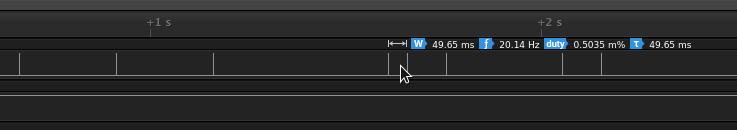

  • Hi, perhaps my question would be more clear if I asked to compare it set then clear with toggling twice:
    double_toggle:
    which produces the following waveform that I expect
    compared to set_then_clear:
    which produces pulses at random times and sometimes according to the timer.
    I am looking at the time between of the pulses and not the width of the pulse high-level.
    Both tests were done on the same piece of code without changing any other lines. Is this a bug in the SDK?
  • Your logic analyzer isn't catching the smaller spikes.
    Try setting the level (1.8V), and the sampling rate to >50 MSPS:
    Håkon
  • Thank you Håkon,
    It appears that I was indeed witnessing aliasing.
    I haven't tested for these specific examples, but I did witness an improvement when increasing the sample rate for a different piece of code which is also toggling the pins similarly.
