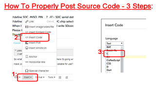

    It would be easier to analyse & explain the messages if you copied them & pasted text
    Post as for source code, but omit step 3 (ie, leave as just 'Text):
