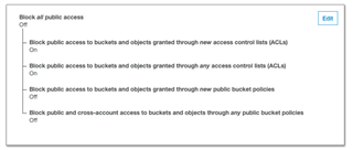

I use the same region in AWS IoT and S3
I've already checked this thread.
https://devzone.nordicsemi.com/f/nordic-q-a/52039/aws-fota-sample/210098#210098

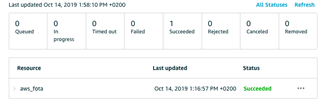

  • Did you attach the policy I suggested to the certificates of the thing in AWS IoT Core? Does your job ever go from Queued to In progress if you click on it and see the status fields?
    It should progress from Queued, In progress then to either Failed or Successful.
    For v1.0.0 your device has to be connected and subscribed
    [mqtt_evt_handler:196] SUBACK packet id: 2112
    before you create the job. Also, ensure that all your old jobs are canceled and deleted as a device can only have 1 active job at the time. So if there is a job already for the device it will block any new jobs created.
