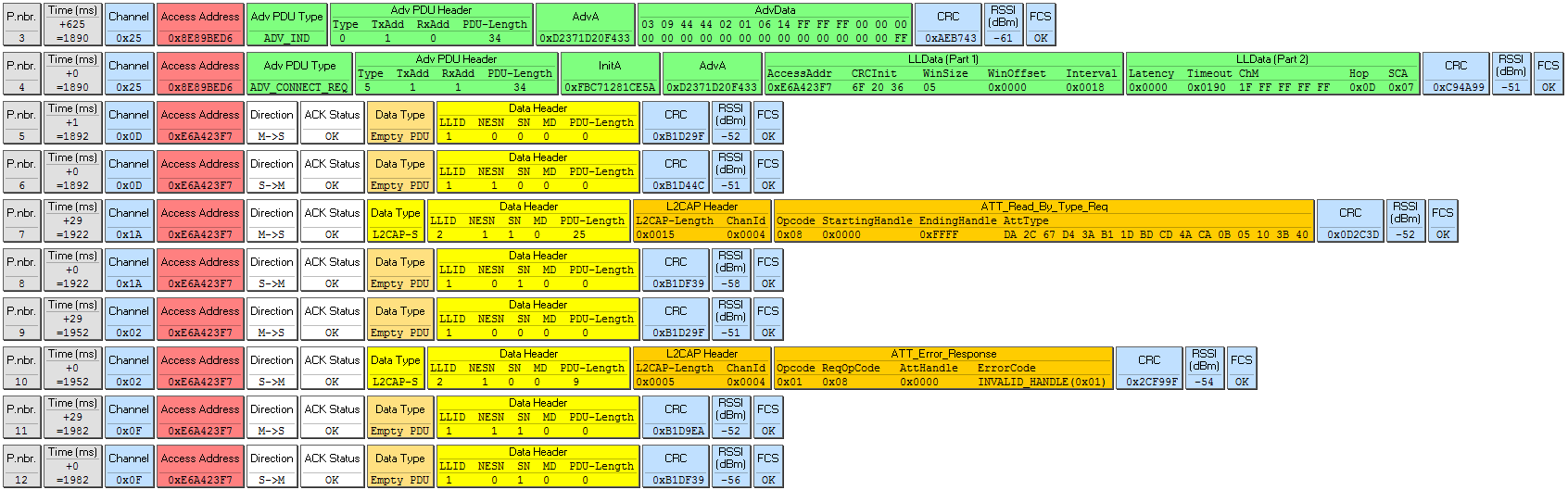

I used a CC2540 USB dongle from TI to do some sniffing on the Bluetooth communication:
image description
The forum seems to resize the screenshot, please check the following attachment for a larger version: BT_READ_BY_UUID_ERROR_SNIFFING_LOG.png
This log shows that the read request is sent with the correct UUID (the first Byte on the UUID packet is the rightmost byte in common UUID representation - I also used the same #define when registering the base UUID with the SoftDevice.
As you can see, the reply is an error code INVALID_HANDLE(0x01) from the Peripheral.

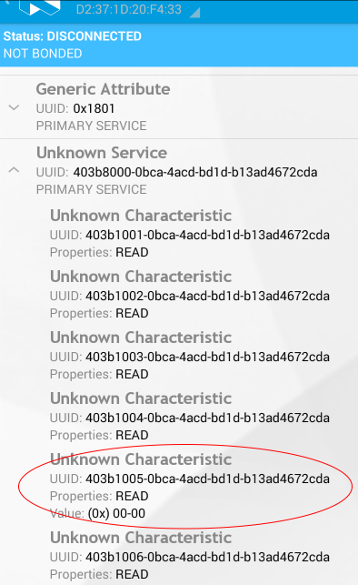

A characteristic value with this UUID definitely exists in the Peripheral, as you can see in the following screenshot from Master Control Panel (on the Peripheral, exactly the same software is used):
image description
Does anybody know what went wrong? How is the Read by UUID function used correctly?
  • Ooookay, this is really a very stupid bug:
    I specified a handle range from 0x0000 tu 0xffff.
    If I set the handle range from 0x0001 to 0xffff, everything seems to work fine.
