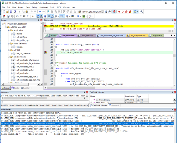

During a DFU on SDK15.2 the BLE connection is terminated. The NRF_BL_DFU_INACTIVITY_TIMEOUT_MS is set to 120000.
After 2 minutes, the device still has not reset and started running the application again.
This same test on SDK14.0.0 will restart the device after 2 minutes of inactivity.
Using the Keil Debugger, confirmed that inactivity_timeout() is being called after two minutes
but the call to bootloader_reset() does not recover the device.
Screenshot attached.
  • Determined that the issue is related to the use of WDT. When WDT is enabled, the reset does not work. When WDT is disabled, the reset is working. We need WDT enabled. Even with WDT enabled on SDK14.0.0 Bootloader, it was still able to reset.
  • Hi Mark,
    Could you check if the inactivity timeout is triggered or not ?
    If the reset didn't happen, what does the bootloader do ? does it advertise ?
    How do you feed the WDT inside the bootloader ?
