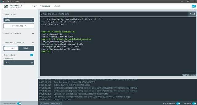

  • Hi, maybe I have your same problem,
    I have to program 2 board (nRF52840 DK and the BC840E) with the radio_test application.
    When I connect only the nRF52840 board to the PC and load the zephyr.hex programme (i.e. without the 10 connection wires to the BC840E) the serial terminal seems to work, so it seems to work for nRF52840 DK.
    Instead it prints in the serial terminal continuously the values "bfdegeffcgfedd e!e "f#d$f%f&e'e(f)f*f+c,e-f.g/f0d1g2g3f4f5c6f7g8f9g:c;d<e=g>g?c@eAfBfCgDdEfFeGfHfIdJeKfLeMgNdOfPddffeedee d
    f
    f
    ceffgadfgfddedbgfe e!b "e#f$f%f&e'f(f)e*g+d,g-e.f/g0c1f2f3g4f5e6g7g8e9e:a;g<d=e>f?b@eAfBgCgDdEgFeGfHfIcJfKfLeMhNdOfPfehfeedcd e
    f"......" if I program the nRF52840 with the 10 connection wires attached and then the BC840E as well.
    I tried changing USBs and Putty and the same thing happens.
    How can I load the program in the BC840E? I'm pretty sure the problem lies in flashing the programme on nRF52840 when the other board (BC840 E) is also attached via 10 wires, because only in this case does the programme give problems.
    If by chance it is the same problem you encountered, how can I solve it?
    I also tried to solve the problem in the last answers of this post.
    Thanks in advance!
