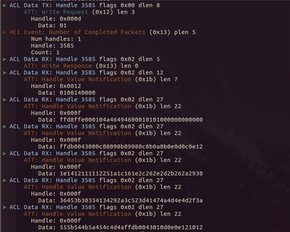

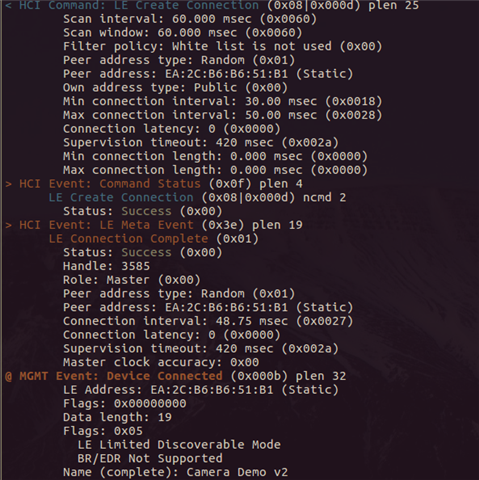

  • I've taken some more snippets of the successful image transfer, and an unsuccessful image transfer, as well as the connection messages for both sides. Something interesting that I've noticed on the client that's having trouble, is that there seems to be a
    Here the connection log on the working device
    And here is a successful start to an image transfer. A notification comes up through 6e400004 (handle 0x0012) and then the image transfer data begins streaming over 6e400003.

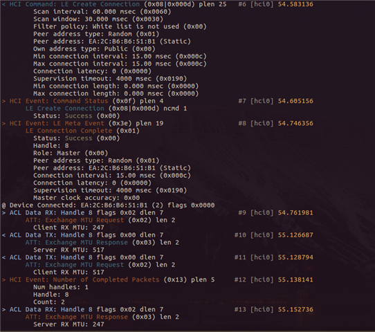

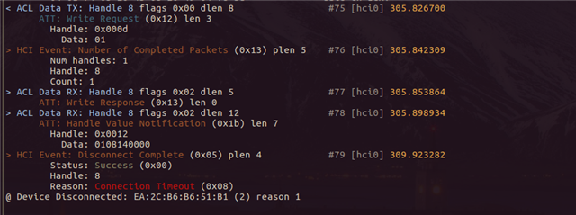

    Here is the device connection on the non-working device.
    And here is the unsuccessful image transfer on the non-working device. The image info notification propagates up through 6e400004, but nothing comes up through 6e400003, and the device times out. I can't see anything that explains the problems from this picture, other than the fact that the device that doesn't work isn't getting the notifications with the image data.

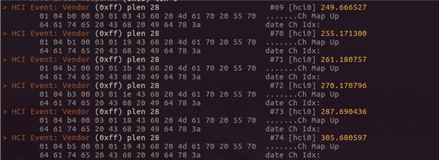

    Something else that I've noticed that is different between the two, is that the non-working device records this odd bluetooth event every ~15 seconds while idle, although the timing is inconsistent. The working device does not record this message while idle. This might not be related to the problem, but I figured that I would include it.
