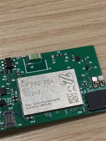

Hi Nordic team,
Anyone can confirm the below module revision can support GPS?
it marked B0 1922AG.
thanks,
Suttichai

The nRF9160-SICA supports NB1, M1, and GPS:
https://infocenter.nordicsemi.com/topic/ps_nrf9160/ordering_info.html?cp=2_0_0_12_4#prod_opt
Håkon
Hi Hakon,
Sorry I miss understood that some revision of module has GPS issues such as module on nRF9160 DK version older than 0.8.5.
Actually its onboard antenna issue (on DK), am I right? Every revision of module already support GPS without bugs? That’s why I asked.
best regards,
Suttichai
Suttichai said:Actually its onboard antenna issue (on DK), am I right?
That is correct. Version 0.8.2 (and lower) of the nRF91-DK had issues wrt. GPS performance: https://infocenter.nordicsemi.com/pdf/nRF9160_DK_Errata_v0.7.pdf?cp=2_0_5
This was a DK issue (and is now fixed), and not a SiP issue.
Håkon
