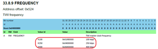

I have a question regarding the frequency of the SPI peripheral of the nrf52.
According to the Product Specification v1.4, the minimum value for the frequency is 125kbps, setting the register to 0x02000000
We have made a test with lower values and the spi peripheral seems to work fine.
Would it be possible to have your feedback about using lower values, not reported in the Product Specification document ?
Would it be possible to know the function f for f(clock_frequency) = Register Value, if exists ?

  • Hi jev,
    at the end it was possible to set lower speed than the ones reported in the manual (regarding the SPI peripheral), but note that there is a kind of approximation. I do not remember exactly the value of that (might be rounded_value = (value + 0x800) & 0xFFFFF000), so the consequence was that in my case i could not reach the SPI baudrate i wanted (9600 bit/sec).
    So, as you said, I tried the SPI slave feeding the clock with another pin of the Nordic configured as GPIO controlled with a TIMER (PPI approach). In order to control the Chip Select of the SPI I used to activate the its pull-down.
    I did a couple of test and it seems to work properly. In our product we did not adopt the SPI slave then, so I did not perform further and thorough tests. But I hope this could help you to give a try.
