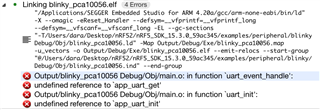

Output/blinky_pca10056 Release/Obj/main.o: in function `uart_init'
Hi, I try to combine example Blinky with Uart. but i have problem error as link below
Output/blinky_pca10056 Release/Obj/main.o: in function `uart_init':
undefined reference to `app_uart_init'
please check my code
my code

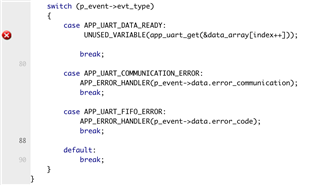

void uart_error_handle(app_uart_evt_t * p_event)
    if (p_event->evt_type == APP_UART_COMMUNICATION_ERROR)
    else if (p_event->evt_type == APP_UART_FIFO_ERROR)
    static uint8_t data_array[UART_RX_BUF_SIZE];
    static uint8_t index = 0;
    uint32_t       err_code;
    switch (p_event->evt_type)
        case APP_UART_DATA_READY:
             UNUSED_VARIABLE(app_uart_get(&data_array[index++]));
        case APP_UART_FIFO_ERROR:
        default:

  • You forgot to add "app_uart.c" to your project or Makefile. Sould be in SDK_ROOT/components/libraries/uart folder.
  • i Turbo J
    i have include in User Incluse Directiories already but still error

    here is my error output
  • Clean your glasses: I was talking about a .c source file - and not about include files.
