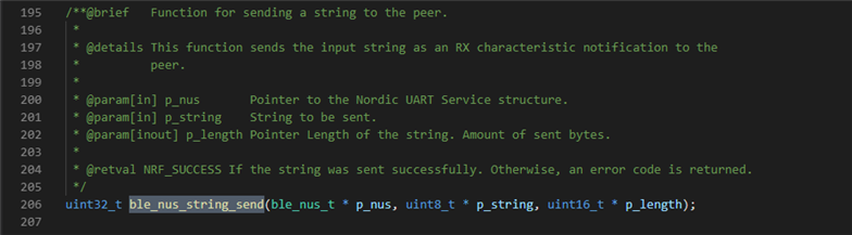

  • Thanks Andreas. I was thinking that using the ble_app_uart example with saadc will suit my application more.
    The function used in my code “err_code = ble_nus_string_send(&m_nus, my_data_array, BLE_NUS_MAX_DATA_LEN); “ is replaced by following function in latest sdk.
     uint32_t ble_nus_data_send(ble_nus_t * p_nus, uint8_t   * p_data, uint16_t  * p_length, uint16_t    conn_handle)
    How can I use the new function without sacrificing the original functionality.

  • Hi.
    Have you taken a look at the API description?
    They are basically the same, only difference is that ble_nus_data_send requires the connection handle to the destination of the message as input.
    Andreas
  • I was able to use the new function but I my program always ends up in a break point condition after log_init(). Am I initializing something multiple times ?
