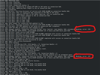

I have an application to develop in which Central device is scanning with use of whitelist if it is not connected but have saved peers.  If peer list is empty, device shouldn't scan at all and if user will choose proximity pairing mode - it should scan for every peripheral with specified name.
I have implemented it basing on ble_app_hrs_c example and after connection to peripheral device, peer manager is returning an error NRF_ERROR_NOT_FOUND when callingpm_whitelist_set function. In function whitelist_load() from ble_app_hrs_c example it looks following:

So there is one peer and even pm_peer_count() function returns 1 but for some reason pm_whitelist_set() function has problem in finding it.

  • And about main issue I think I solved it (since it seems to work now)
    There was a problem that I wanted to add a peer to whitelist just after bonding procedure is finished. Now, I think its not possible and the only moment when I can do that is after NRF_BLE_SCAN_EVT_WHITELIST_REQUEST event like in the ble_app_hrs_c example.
    Then another problem with code 0x3204 occurred. And it turned out that advertising have to be stopped before  pm_device_identities_list_set function can be called.
    After those two fixes it seem to work. I think it would be nice to consider to add some more documentation to ble_app_hrs_c example in order to clarify such important aspects
