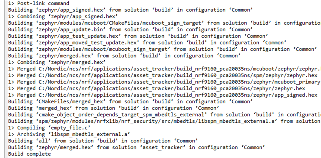

I'm currently unable to build the asset_tracker for Thingy:91 on Segger Embedded Studio - using nrf9160_pca20035ns for the nRF Connect SDK Project
Do anyone have an idea why this occurs?

Hi.
I assume you are on the master branch?
Which commit are you using? I am able to build using 0a9d1b79.
From the picture, it looks like you are getting more errors than just the one, can you share the rest of them?
Didrik
I'm using ncs_tag v1.0.0 and the list of errors, all related to spm.c follows below.
Can you double-check which commit you are on in the nrf repo?
And run west update to make sure that the other repos are on the correct commit?
And what version of west do you have?
Executed some west-commands and the output was as follows - sorry for the crappy formating but I assume it holds the current ststus of the repos I have checked out

When I try to open the asset_tracker application in SES using v1.0.0, I can choose between nrf9160_pca20035_v0_2_2[ns] or nrf9160_pca20035_v0_3_0[ns], but not nrf9160_pca20035.
What do you get if you run git rev-parse HEAD in the nrf repo?
Are you able to build the project if you use the master branch?
Remember to run west update and check the "Clean Build Directory" checkbox when changing branch/tag/revision.
As mentioned, I have tried several different approches - the latest cloning the fw-nrfconnect-nrf onto my source dir, and the HEAD is e9f0bc0e3ebfab249d8906c12ad060418b16f238. v1.0-branch, and nrf-source directory is neamed fw-nrfconnect-nrf. Not nrf.
I tried all the [ns] variant you mention without any luck.

Did you follow the "Getting Started Assistant" when installing NCS?
What python scripts are you talking about? The requirements files in {zephyr, nrf, mcuboot}/scripts/requirements.txt?
Yes, I followed the "Getting Started Assistant" when installing NCS -
And yes, the Pyhton scripts I'm refering to are those that seem to deploy the requirements description/files.

When running
pip3 install -r nrf\scripts\requirements.txt
the printouts tell me that most of the requirements are met but I also get a lot of red printouts as well.
Below is a random tiny fragment of the printout from the above command,
containing the Microsoft Visual C++ 14.0, which I find strange unless it is related to SES in some way.
... ... running build_ext generating cffi module 'build\\temp.win-amd64-3.8\\Release\\pygit2._libgit2.c' creating build\temp.win-amd64-3.8 creating build\temp.win-amd64-3.8\Release building '_pygit2' extension error: Microsoft Visual C++ 14.0 is required. Get it with "Microsoft Visual C++ Build Tools": https://visualstudio.microsoft.com/downloads/ ---------------------------------------- ERROR: Failed building wheel for pygit2 Running setup.py clean for pygit2 Building wheel for editdistance (setup.py) ... error ERROR: Command errored out with exit status 1: command: 'c:\python38\python.exe' -u -c 'import sys, setuptools, tokenize; sys.argv[0] = '"'"'C:\\Users\\dagak\\AppDat ... ...
Anyways - I'll look further into this tomorrow.
What Python version do you have?
Some of the dependencies have not yet updated to Python 3.8, so we recommend still using 3.7.
Regarding the specific error you get, the Python library is based on a C library. To build the C library, you need the "Microsoft Visual C++ Build Tools" toolchain.
So there is no need for the full Visual Studio, you just need the C++ toolchain.

I just managed to build the asset_traker in full - on two PCs. Hurry:-)
Lessons learned:
According to your last comment on python38, this might be the reason for the massive red output when installing the stuff based on the nrf requirements, but asset_tracer was regardless built successfully.
Last question: Do you think that I should use Python37 instead og 38 for now?

Great to hear that you got it working!
I would use 3.7, as I know that it works. I do not know how big of an issue it would be to use 3.8, but to be safe I would recommend using 3.7.
You should be able to downgrade using the following commands:
choco uninstall python choco install python --version 3.7.3
