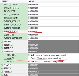

twi register shows:
the STARTTX task is not triggered, and what event can trigger this task?
i doubt if the PPI channel twi use collides with other event/task ?

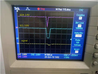

    Are you able to see what happens (if anything) on the TWI lines (with a logic analyzer for example)? Do they go low at any point or is the problem that the TWI doesn't start sending at all? In that case, can you show me the snippet of code where you initialize your TWI, please?
    Simon
  • thanks for your reply!
    unfortunately i don't have a logic analyzer, so i use a oscilloscope to capture SCL and SDA signals , they runs fast  so i can only get part of it.
    they go low when i press the button(start transmission), i may get the whole waveform with a logic analyzer.

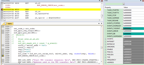

    "TWI TXD byte sent" is differnt form what i said before,i sent two bytes,  the EVENTS_TXDSENT is 1(not 0), and turns 0 when the nrd_drv_twi_tx finished.
    the following is part of my code:

    i get  NRF_DRV_TWI_EVT_DONE and m_xfer_done = true, but there is no respones of slave device.
