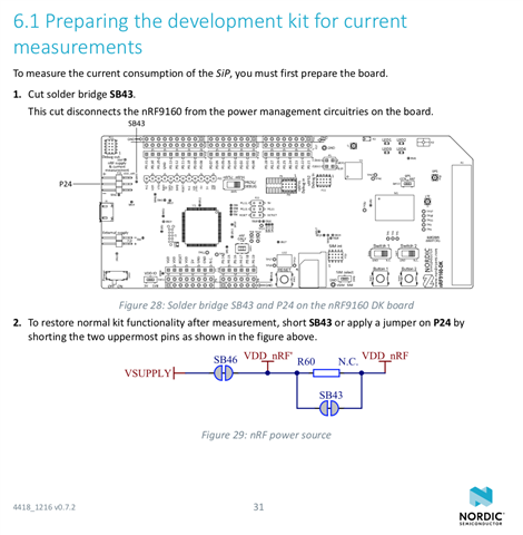

Don't find SB-44 on my nRF9160 v0.8.5 dk for current measurment.
I am trying to configure my nRF9160 v0.8.5 dk for current measurement and found out that SB 44 is missing on my kit. As the user manual suggest that in order to enable P24 for current measurments we have to cut SB44 first.
Secondly, I am using low end oscilloscope(tektronix TDS 2024C) with minimum resolution of 20mV to measure the small voltage drop(micro volts for micro ampares with 0.5ohm resistance).Do I need some amplifying circuit after P24 to measure with oscilloscope.
