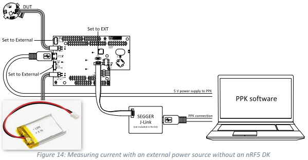

To measure the current consumption of our external battery powered device I plan to do the following
(as described in chapter 6.6. of the PPK User Guide v2.2, Figure 14) :
a) Disconnect the LipO battery from our device and attach it as external power supply to the PPK
b) Connect our device to the external DUT connector (P16) of the PPK
This should allow power measurements for the normal mode (discharging the battery)
However our device may charge its battery, when it is attached to a separate 5V (USB) connection.
If possible I would even like to measure both discharging and the "reverse" charging current (but it may be up to 200 mA (for a short time).
1) Is it possible to measure not only discharge current, but also charging current with the PPK (with this setup or another setup) ?
2) If it cannot be measured, does the PPK allow the charging (will the current flow) ?
3) Or in the worst case, would it damage the PPK ? Does it make a difference if discharging current is e.g. limited to - 70 mA ?
My goals are
a) to measure discharging AND charging current
b) even if that is not possible, not having to change the measurement setup (cabling) for intermediate charging
