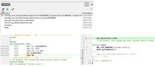

  • Jared,
    I was able to use the new function but I my program always ends up in a break point condition after log_init(). Am I initializing something multiple times ?

    Is any error code thrown? Where exactly after log_init() does the program stop?
    regards
    Jared
  • Adding disassembly.
    NRF_BREAKPOINT_COND;
    // On assert, the system can only recover with a reset.
        E003        b 0x00027FC2
    --- app_button.c -- 270 ------------------------------------
    if (!nrf_drv_gpiote_is_init())
    err_code = nrf_drv_gpiote_init();
        F001FCA3    bl 0x00029904 <nrfx_gpiote_init>
    --- app_button.c -- 275 ------------------------------------

    I can't tell from the images where it asserts, the quality of the uploaded image is too low. Can you tell what function is causing it to go the error handler when you step through the code?
    regards
    Jared
  • The error is in the log_init().

    Compile the project in debug mode and comment out the NRF_BREAKPOINT_COND. The project should now print out the error code to the terminal when you run it.
    regards
    Jared
