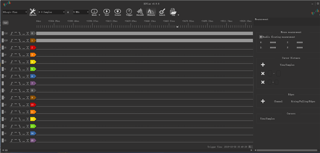

This screenshot shows the normal case, the first line show the voltage level of CLK pin and the second line shows the DIN pin.
when I doesn't start the BLE advertising, PDM interface works well.

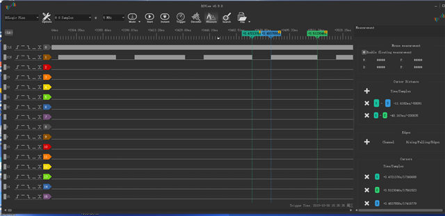

This picture shows the case when I start the BLE advertising, as we can see the waveform at the DIN pin becomes intermittent, the repetition period of interference is  40.167ms,just same as the advertising interval of BLE, so I presume this is cause by BLE transceiving.

    the PDM driver should place all the received data directly to DMA without being affected by the SoftDevice using the CPU for BLE purposes.
    Can you check if the buffers are full when the PDM transmission stops, i.e. if the NRF_PDM_EVENT_END occurs just before the gaps?
    If this is the case, then  it is possible to get notified by the SoftDevice in advance of any BLE activity by using the Radio Notification feature. This way you can set up a new and empty buffer just before a BLE activity to ensure contineous sampling.

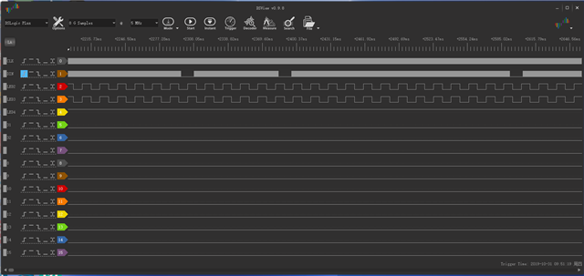

    I do a experiment to prove this:
    1, I modify the PDM callback function like the following, each time when a buffer is requested or released I will invert an LED.
    2, I connect the pins controlling these LED to my logical analyser, they are P0.14 for LED1, P0.15 for LED2, P0.16 for LED3.

    This is the result I got:
    As you can see, LED2 and LED3 keep toggling even in the gaps, so I believe no NRF_PDM_EVENT_END happend.

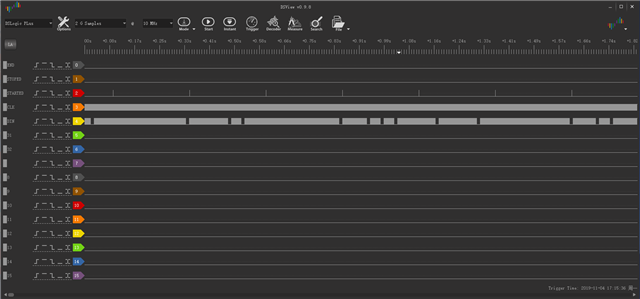

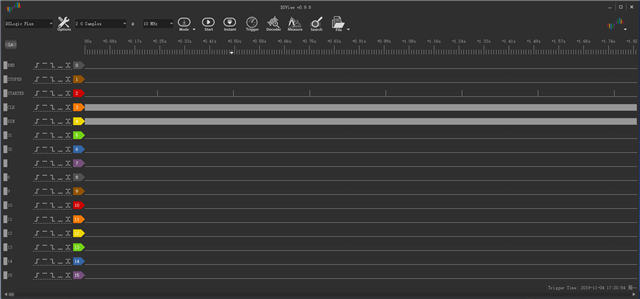

    As you advise, I add toggle pins in the PDM event handler, here is the result:
    1,BLE advertising enabled.
    2,BLE advertising disabled

  • I don't believe this is a buffer issue. If the PDM peripheral stops because of a lack of buffer, same result should be got when I stop the bluetooth advertising, while, in fact, the gap is gone and PDM woks normal when I stop the bluetooth.
    The SoftDevice will interrupt the application and use the CPU for pre-processing of BLE events. Hence, if the buffer is filled up just as the SD interrupts the application, then the pdm_buffer_handler would not be allowed to run until the SD is finished. When not starting any advertsing or scanning, then there would be no events that would interrupt the application and possibly delay the buffer change.
    However I agree that it does not appear to be the case as the DIN gaps occur after the STARTED event when there should be plenty of space in the buffer.
    In screenshot 1, I see that the DIN line is pulled low aperiodically, while the advertisment events should be occuring every 40ms based on the advertisment interval set in the main.c . I see that you are using the ble_app_uart example, which doesnt set any scan response data so is the periods when the DIN line is low when you are connected to the nRF52840 with aphone and transmitting data to the nRF52840?
    I am afraid that I do not have a PDM device to generate a PDM output to sample with the PDM peripheral. I will see if I can get hold of one to do some testing today.
