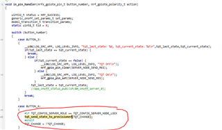

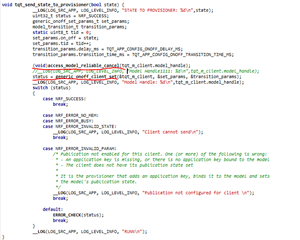

My function call generic_onoff_client_set() is tqt_send_state_to_provisioner() like this:
and when I call like this It can run:

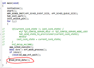

But when I add UART and call is run to the error:
this read_RFID_data() will call tqt_send_state_to_provisioner() to call generic_onoff_client_set() then the error happen.
