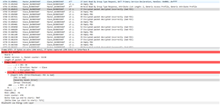

Recently, i started facing the below issue:
Once i try to pair the module with the smartphone ( in this case, samsung), its paired fine. Problem happens once i disconnect and try to connect again. Once i try to connect back, it gets disconnected throwing  error --> BLE_HCI_CONN_TERMINATED_DUE_TO_MIC_FAILURE.
I understand that somewhere message was not decrypted correctly but my question is, why now? It has not happened before in the few months we have been developing. Suddenly this issue came up.
I tried erasing the module and loading the SD and app again but it still has the same issue. With my older version of the FW, it is throwing issues now.
Attached is the nRF sniffer log from Wireshark that i captured
MIC_FAILURE
Could you guys tell me what can be the cause here? Why will it happen all of a sudden? What can be done to ensure this never happens?

  • SK said:
    I found the below link and it seemed to solve the issue.
     Great!
    SK said:
    I wonder why though? Would you know anything in this regard?
    Likely an issue with the phone, happening internally in the Bluetooth stack on the phone. A sniffer trace comparing 900ms vs 400ms delay timer might give us some clues, but since this is happening internally on the phone, it’s difficult to say exactly why it’s not able to handle the request at 400ms.
