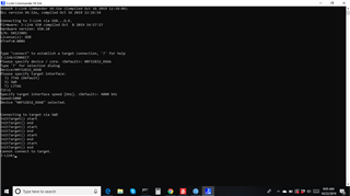

     No Hakon we can't able to connect with jlink Commander look the below screen shot same issue are showing with those boards

  • This image that you posted:
    Showed a successful connection to the nRF52832 device.
    If you had followed up with a "mem32 0, 100" that should have given you the first 100 words in flash.
    What has likely happened with your device is that it is asserting, where it then resets. If this happens very early in the boot-up sequence, it is very hard to recover the chip, as it does take a bit of time before the debugger is successfully attaching to the device.
    If that is the case, you can try this script: https://devzone.nordicsemi.com/f/nordic-q-a/45078/nrf52832-not-connected-anymore-after-first-trying-to-debug-keil/177579#177579
    But, what is interesting in your latest picture is that the sampled voltage is 0.00V. Is the "VREF" pin not connected to the 10 pin programming header? Your debugger does not have any information about the target voltage of your custom board, so it has to guess what it is (or; just try to connect with 3.0V).

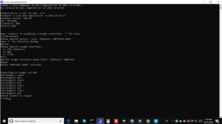

     That image is from working board not from the boards showing these issue. Sorry for the confusion
     The voltage is not showing because i open the jlink commander without custom board connected to debugger that's why its look like that.
    look these screen shot your doubt will clear
     we are programming through a 6 pin needle connector not a 10 pin .
    we are only using(SWDIO,SWCLK,GND,VDD) .
