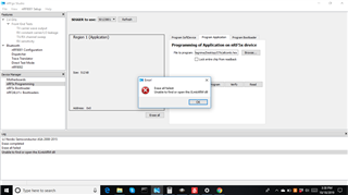

  •  We are mainly using "nRFgo Studio" and "nRF Connect" application for erasing and flashing codes to our custom board and its taking place successfully for a long time.
  • The hardware tools we are using for flashing the code is "J-LINK BASE " version 10.1.
  • But now  we can't able to flash or erase the code to our custom board either with "nRFgo Studio" or nRF  Connect.I don,t known why its happening?
When i tried to erase the code in our custom board using "nRFgo Studio"

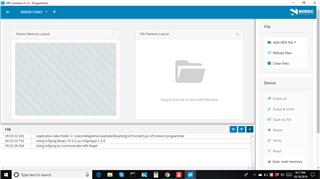

When i tried to read our custom board using "nRF_Connect" its not reading look the below screen shot

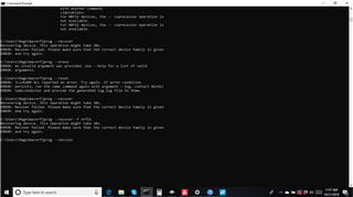

  • When used nrfjprog to erase or flash the code below errors are showing.
    please reply as soon as possible.
    Its recommended to use nRF connect programmer for programming nRF5-series devices, as nRFgo Studio isn't maintained anymore.

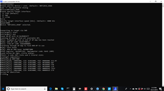

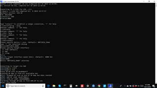

  • Håkon Alseth said:
    Q2: Have you tried to use JLink Commander, and what was the output from that?
    These is what i getting from the jlink commander.
    I don't known what are the commands i want type here please help me .
  • JLink Commander seems to be able to connect successfully, you can try to read out the memory using "mem32 0,100", which will read the first 100 words in flash.
    What version of nrfjprog are you using? If it is old, then that might be the problem.
