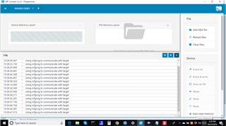

  •  We are mainly using "nRFgo Studio" and "nRF Connect" application for erasing and flashing codes to our custom board and its taking place successfully for a long time.
  • The hardware tools we are using for flashing the code is "J-LINK BASE " version 10.1.
  • But now  we can't able to flash or erase the code to our custom board either with "nRFgo Studio" or nRF  Connect.I don,t known why its happening?
When i tried to erase the code in our custom board using "nRFgo Studio"
When i tried to read our custom board using "nRF_Connect" its not reading look the below screen shot
DOUBTS
  • What is the reason behind these issues?
  • Is it a problem with our custom board or with jlink tool?
  • What are the solution for these problems?
Please reply as soon as you can possible . Its a major issue with us.

    Have you tried this on another PC? The error messages shown now looks to be related to your debugger, not the actual connection to the nRF, as shown in your attached picture:

    Leave that error part in log terminal. Its came when i try to remove the connection between jlink and nrf device after waited for long time .
    The only thing showing on the log terminal is "using nrfjprog to communicate with target" .
    I told you already  that without firmware the same issue is showing . Is there any solution for that?

     yes in all pc the same issues are showing.
    Look these screen shot all your doubts will clear
