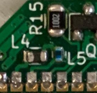

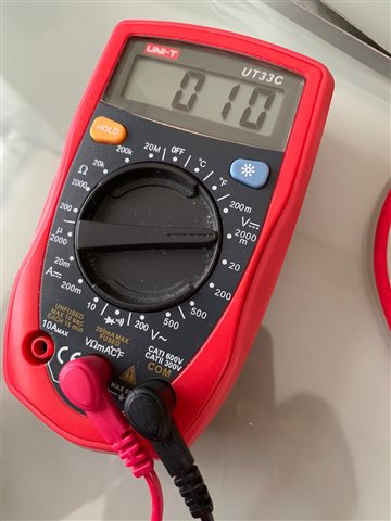

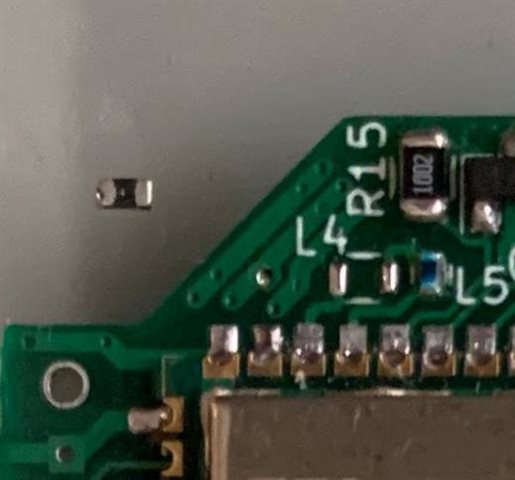

    Just to make sure I understand the behaviour, I have removed one of the 2 serial inductors in our custom board to simulate the case of improper reflow.
    As expected, the board would still works, possibly in LDO mode, but the DC voltage at DCC drop to about 10mV.
    Once the inductor has been reinstalled,

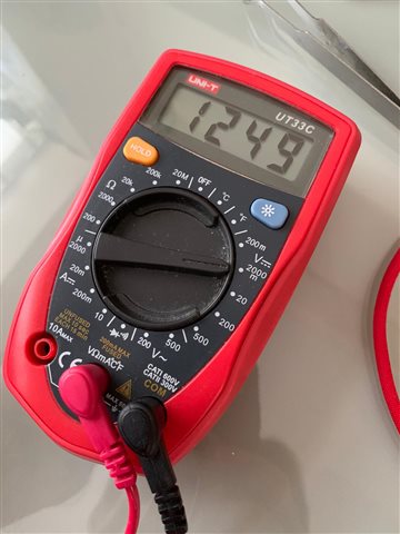

    voltage at DCC is restored back to normal level of about 1250mV.
    The voltage at DEC4 remains at about 1250mV(DC) with the inductor on or off. It seems like I only need to test the voltage at DCC pin and this should provide a quick way for testing whether the DCDC is working or not. Would you be able to duplicate my experiment and confirm my results?

    And you are correct, the board won't even start without the inductor installed. After I reinstalled the inductor, the voltage at DCC and DEC4 are both 1217mVDC using my multimeter. So basically, we can be sure that reflow is done properly if we know that that software has enabled DCDC at the beginning of the main function as follows
