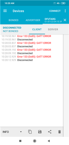

BLE DFU example is not connectable
I have been trying to get the BLE secure DFU example working on a custom board (nrf52840 - BC840 module). I tried it on SDK 15 and SDK 16. When I flash the BLE DFU, I can see it advertise on my mobile (nrfConnect) but I am unable to connect.
I can, however, connect to it using nrfConnect on the PC. But I have noticed that the RSSI seems a little lower than usual anyhow.
You might think this is a hardware issue but:
  • I flash, s140 6.1.1 softdevice + my app -> no issues
  • I flash pre-compiled "secure dfu test images" -> no issues
  • I compile the SDK 16 secure BLE DFU example, I make flash_softdevice + make flash -> issues
  • I have also used the SDK 15 BLE DFU example but I needed to merge the softdevice and bootloader -> issues
My first idea to solve this was to check my sdk_config.h and make sure that the LF clock settings are correct. I have tried a number of settings without luck. I have on LF crystal on board, but even when I chose the RC clock, it had the same issue.
Finally, I have a nrf52832 dev board (BMD-350-EVAL). When I program the exact same example to the dev board it works fine. So my guess is there is something different about the nrf52832 vs nrf52840 examples/hardware. But I am not really sure.
You help is appreciated!

  • Yes your correct, the log is from the nRF Connect app on my smartphone.
    I have not set it. This is in the sdk_config:
    #define NRF_DFU_BLE_REQUIRES_BONDS 0
  • Ok, could you flash the debug version of the bootloader example for the nRF52840, i.e. the one found in nRF5_SDK_16.0.0_684aa2c\examples\dfu\secure_bootloader\pca10056_s140_ble_debug and post the log output from the device when you connect to it with your smartphone. Also please post the entire log from nRF Connect on the mobile side.
  • Ok so, I got this from the RTT Viewer

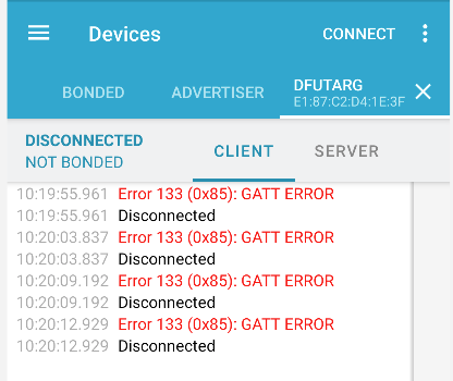

    And this is the log from my mobile phone.
    As you can see I tried to connect 4 times. This error code is different than the one I get from the pca10056_s140_ble project.
  • A new board arrived with an ISP-1807 module and this issue is no longer a problem. I am not sure why it was causing issues on the BC840 module - and it was confusing because everything else worked except the bootloader. Even during normal application, I could advertise and connect on my phone.
    Anyway, this now works on the new board. Thanks for your help.
