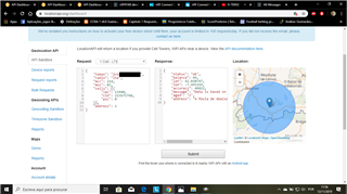

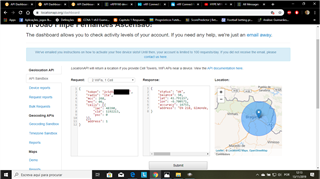

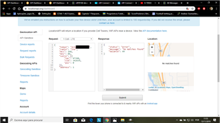

Images where I test the geolocation to (https://locationapi.org/dashboard)
Spain Values from iBasis sim card
Portugal Values from NB-IoT testing sim card
Portugal, Values from phone app with normal sim card without NB-IoT

    This doesn't seem to be a problem with the device or LTE Link Monitor since the same error shows up in the location API. The problem with GPS in the earlier versions of the nRF91 DK is not your problem either.
    I suspect you are connecting to a base station that is not yet public, which would explain why the location API cannot find it. I suggest contacting Altice and asking about the NB-IoT network you got access to.
    Also, since your cell phone isn't connecting to the base station with the same protocol as the DK, it's probably connecting to the closest one, while the DK connects to the closes one that supports NB-IoT.
    Heidi
