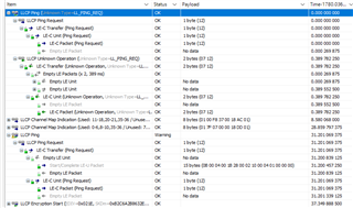

We have noticed that with an iPhone 11 with IOS 13.2. We have a lot of disconnection because our device simply didn't respond to a ping request.
Our device is an nRF51822 with SDK9.  Here is a trace showing a first succesful ping request followed by a failed one. After that there is a disconnection with reason 0x2A - BLE_HCI_DIFFERENT_TRANSACTION_COLLISION.
Do you know how is it possible to fix this issue?
