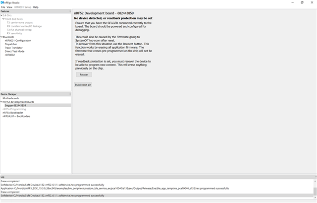

We have a set of custom boards I am working on debugging. I was able to get our software onto the device via nrf jprog tool by uploading a merged hex file (with SD + bootloader + application). The GPIO appeared to be working normally but I was unable to connect to the modules over Bluetooth. So I tried to upload a simple custom service application (based on ble_app_template) to test the BLE connection with nothing else enabled. I used nRFgo to erase all on the custom board and then attempted to flash the softdevice hex (s132 v6.1.1). After doing so the board immediately disappeared from the nRFgo interface and showed 'no device detected' (see image below).
Now I am unable to access/program or recover the board, using both nRFgo and nrf jprog tool. I tried --recover, --eraseall, and --reset commands via command line. I get the following error message when trying to reprogram "JLinkARM DLL reported an error..." and the following error message when trying to recover "Cannot connect to any nRF device. Please make sure a device is connected to the debugger and supplied." This happened the exact same way to two of our custom modules, which were both running properly with our software (although not connecting over BLE) before the error occurred.
Any ideas as to what the issue could be / how to recover these custom boards?

    Based on the serial number, it seems that you are using a nRF52-DK to program external devices.
    In this setup, where the nRF52-DK is acting as the programmer to an external board, it is very important that the external board is powered with the same voltage as the nRF52-DK (3.0V)
    Are you powering your custom board from the DK itself, or is it battery powered? If battery powered, try replacing the battery to see if you now can communicate with the board.

    Thanks for your response. Yes, the external board is being powered with 3.3V, and i have tried multiple batteries. The remaining blank, unprogrammed prototype boards are functioning normally with the same setup. They are visible in nRFgo upon connecting and I am able to upload the merged hex file (with DFU bootloader + Soft Device + Application) to these boards. It's only the two that I had erased and then uploaded the softdevice hex alone that are no longer visible after connecting the battery and the nRF52-DK for programming.

    Could you try to connect via J-Link Commander, and see if it is able to detect the nRF52832 (cortex m4 core) on the non-working boards?

    Sorry dropped the ball on this one. We eventually discovered that a hardware issue was the culprit. A mistake in assembly (incorrect passive component placed) caused the problem. Though the tip to discontinue our use of the deprecated nRFgo studio was helpful and appreciated.
