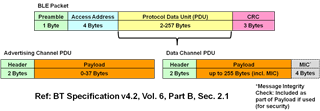

I understand that BLE uses, in the link layer, CRC to verify packet integrity, and drops the packet if is it corrupted. We also use encryption so there's the Message Integrity Check as well.
We did some EMC tests, and when we apply noise at the 2.4GHz band we received corrupted data (we stream data values of up to 22 bit (using uart profile), and we sometimes receive data much higher (32 but values) when the noise is applied). Can it be that the CRC in the link layer and Message Integrity Check are not enabled?
    The CRC is a part of the Bluetooth Packet PDU and cannot be disabled( at least not with our SoftDevices), the MIC will as you have stated be included if the link is encrypted.

    If you say that the CRC and MIC cannot be turned off, can I be certain that the interference influences the data after it is received by the receiver i.e. data corrupted in the air will never pass to my application?
     If the CRC sent with the packet does not match the CRC calculated by the RADIO peripheral on the NRF device, then the SoftDevice's ( i.e. Nordics BLuetooth protocol stack) Link Layer will not acknowledge the package and the peer will retransmit the packet until an ACK is received, see 4.5.9 Acknowledgment and flow control in the BLUETOOTH CORE SPECIFICATION Version 5.1 | Vol 6, Part B, page 2790.
    Invalid CRC matches will not be propagated to the application layer by our SoftDevice.
