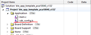

    I really wouldn't suggest starting a fresh, blank project. It would require quite some work to include all the necessary files, libraries, pre-processor definitions and headers, especially if you don't have much prior experience with our SDK.
    I suggest that you find the project that is closest to what you are trying to achieve for your project, and then add or remove functionality from that.
    Otherwise we have the ble_app_template project which is a good template project to start out with.

    ephimee said:
    I already watched all the educational videos. The only comment I have: the file sdk_config.h does not exist.
     The sdk_config.h file is included in most of the examples in the nRF5 SDK.
    I.e. For the template example, you can find the sdk_config.h file in the following folder:
    nRF5_SDK\examples\ble_peripheral\ble_app_template\pca10040\s132\config
    Opening the SES project, the sdk_config.h file should be available in the application folder in the project explorer (ref. attached image below):
    If you have further questions, please let me know.
