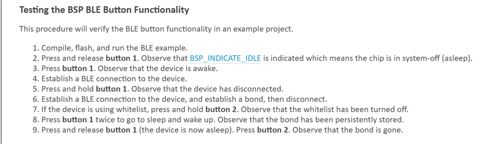

Dear Nordic Support,
I am using nRF52 SDK v16.0.0. I am running BLE peripheral examples. As I read from the examples, the button 1 is used for sleeping and waking the board.
However, if the board is sleeping (SYSTEM OFF), I can wake the board up by pressing any button, not just button 1. Could you please help me with the review? I don't do any modification to the code.
