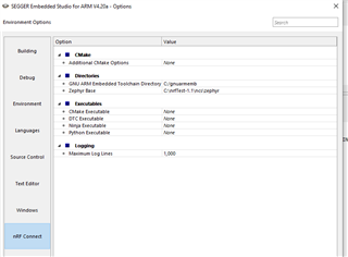

  • I can see that the following line fails for you, and I can see that CMAKE_C_COMPILER is set to C:/Program
    Files/segger/arm_segger_embedded_studio_v420a_win_x64_nordic/bin/cc.exe.
    I tried to build an example and print out CMAKE_C_COMPILER and I noticed that it was equal to C:/gnuarmemb/bin/arm-none-eabi-gcc.exe in my case.  I also tried to run the command, and it gave the following output:
    C:\gnuarmemb\bin>arm-none-eabi-gcc.exe --version
    arm-none-eabi-gcc.exe (GNU Tools for Arm Embedded Processors 7-2018-q2-update) 7.3.1 20180622 (release) [ARM/embedded-7-branch revision 261907]
    Copyright (C) 2017 Free Software Foundation, Inc.
    This is free software; see the source for copying conditions.  There is NO
    warranty; not even for MERCHANTABILITY or FITNESS FOR A PARTICULAR PURPOSE.
    Have you set the GNU ARM Embedded Toolchain Directory in SES? Check out this link for instructions on how to do it. I think that might solve your issues.
    Simon
  • I did
    C:\gnuarmemb\bin\arm-none-eabi-gcc.exe --version
    , and got the same response as you did. No big surprise there. My toolchain in segger is also identical to yours:
    I read your article with great interest, though, and found it very useful in order to make me understand the entire build process and the tool chain.
    Building the gps project with west build gave me a totally different result than the one I got in segger, though. It passed the compiler test, but complained about a non-exixtent include file (do make sure your samples compile before you release!)
    I'm still at loss on how to proceed.
