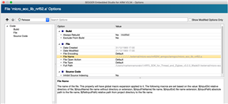

    I tried to build the Eddystone solution and now i hit this issue
    cannot find ../../../../../../../external/micro-ecc/nrf52hf_armgcc/armgcc/micro_ecc_lib_nrf52.a: No such file or directory
    even though I can see this file in that exact location
    So I will try to hunt this down but maybe you have an idea of whats going on here
  • You have to run the .bat/.sh script (windows/mac) located in SDK\external\micro-ecc\build_all.bat[/sh]. This will generate the libraries. (you need a GCC ARM Embedded compiler which you can find here.
    The version you need is mentioned in SDK\components\toolchain\gcc\Makefile.windows
