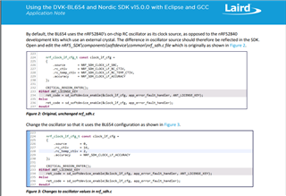

    I think BL654 doesn't have external crystal, you need to change Softdevice Clock Source as mentioned here.
    -> I did change in nrf_sdh.c as given in attached pic
