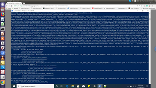

Issue: ADXL362 code build failed on PCA10090
I am trying to build ADXL362 with pca10090ns for nrf9160DK (PCA10090) (west build -b nrf9160_pca10090ns).
I have added the following configurations in prj.conf.  Though the build was failed.
# Sensors
CONFIG_SPI=y
CONFIG_SENSOR=y
CONFIG_ADXL362=y
CONFIG_ADXL362_TRIGGER_GLOBAL_THREAD=y
CONFIG_ADXL362_INTERRUPT_MODE=1
CONFIG_ADXL362_ABS_REF_MODE=1
But I can see that, similar ADXL362 configurations are available at "prj_nrf9160_pca20035ns.conf" and it was successfully building.
I have tried with different versions. But getting following errors
SW: v1.1.0 and below
 error: 'DT_INST_0_ADI_ADXL362_BASE_ADDRESS' undeclared here (not in a function); did you mean 'DT_INST_0_ADI_ADXL362_BUS_NAME'?
  .spi_slave = DT_INST_0_ADI_ADXL362_BASE_ADDRESS,
 error: 'DT_INST_0_ADI_ADXL362_BUS_NAME' undeclared here (not in a function); did you mean 'DT_INST_0_ARM_ARMV8M_MPU_SIZE'?
Please let me know, how can i build ADXL362 code for nrf9160_pca10090ns
