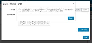

I am trying to upload the firmware with secure DFU using following method:
  1. generated the dfu_public_key.c and private.pem pair
  2. copied the "dfu_public_key.c" into "\examples\dfu" folder
  3. Ran "build_all.bat" to create "micro_ecc_lib_nrf52.a" at "\nRF5_SDK_16.0.0_98a08e2\external\micro-ecc\nrf52hf_armgcc\armgcc"
  4. Compiled "secure_bootloader_ble_s140_pca10056.emProject" and copied "secure_bootloader_ble_s140_pca10056.hex" to the package folder as "bootloader.hex"
  5. Ran "02_flash_SD_and_bootloader.bat" to upload the bootloader
  6. FW.zip was created using "03_create_fw_zip_package.bat"
I can see DFUTarg when I search the devices but when try to upload the FW.zip, it prompts error: "When writing 'EXECUTE' command to Control Point Characteristic of DFU Target: Operation code 4 (EXECUTE) failed on DFU Target. Result code 5 (INVALID_OBJECT)". Please see the attached image of error.
I have been doing this for SDK15.0.0 and nRF52832 for several months. The only difference now is that the SDK is v16.0.0 and chip is nRF52840. I have paid attention when copied the bootloader (which is s140 for nRF52840). Also the DFU example is also for S140 and nRF840. The FW.zip compiled project is also for nRF52840 which, otherwise, works fine on chip.
Please let me know why this error is happening.

  • Hello ,

    But when I try to upload the "my_image.zip" via DFU, exact same error is prompted as noted in the very first post of this ticket:
    When writing 'EXECUTE' command to Control Point Characteristic of DFU Target: Operation code 4 (EXECUTE) failed on DFU Target. Result code 5 (INVALID_OBJECT).

  • I used the buttonless example as an example of the application that I wanted to update to via DFU.
    What HW are you running on? A normal DK?
    Can you please try to unzip an unmodified version of the SDK and:
    1: generate private.key and dfu_public_key.c in SDK\examples\dfu.
    2: compile the bootloader, ble_app_buttonless_dfu.
    3: run the build_all.bat from SDK\external\micro-ecc, and run the script again?
    It should work out of the box like that, if you are running on a DK. What DK version do you have?
    BR,
    Edvin
  • It's a 3rd party DK with nRF52840 module. So the pca10056 and S140 should work on it.
  • Does it have an external LFXTAL, or only RC Oscillator? And what are the specs on the LFXTAL?
    Did you try the unmodified SDK?
  • Yes, I tried unmodified SDK and it miraculously worked.
    Thanks for the help.
