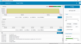

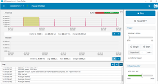

    By using 20 microAmp,  I got Battery life approximately 12 months  Also I got  average current on PPK  which are  different from above calculation.. I have captured 2 images with different average current. I am little bit confused which value i will consider for calculation.
    a)
    b)
