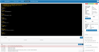

After all this steps, the board still refuses to connect to the LTE-M network. I'll attach some of the terminal monitor printscreens bellow.
    Can you please provide full output from the LTE Link Monitor? Please issue the command AT%XMONITOR (as the example in the bottom of page) as well.
     Sure, here's the output:

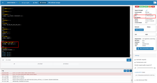

    Later edit: Something that concerns me is that the AT+CPIN? command returns the following:
    AT+CPINR="SIM PIN"
    +CPINR: "SIM PIN",3
    However, the GUI of the LTE Link Monitor cleary says in the top right info panel: Pin: no PIN required
    Trying to set the PIN number via AT+CPIN="0000" results in ERROR being displayed. Could you please offer a clarification regarding this?
     Please note that it says AT+CPINR and not AT+CPIN. CPINR = The set command returns the number of remaining Personal Identification Number (PIN) retries for the User Equipment (UE) passwords.
    While AT+CPIN? == READY, which is correct, and indicates no pin required.
     Shouldn't the SIM pin be set to the one found on the flyer it came with? (in my case that's 0000)
    Trying to set it via AT+CPIN="0000" results in ERROR message being displayed.
  • Ok, so your output indicates that it does not find a network:
    CESQ: 99,99,255,255,255,255.
    All values mean Not known or not detectable
    I suggest asking the local LTE-M provider directly regarding LTE-M coverage. I.e. try with their SIM.
