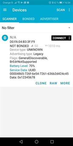

    I send you screen capture of the result I must have in final.
    So a service data ( 0x16 ) with the value of the Battery level and an other one
    service data ( 0x21 ) with 128Bit UUID with 4 bytes of data ( in fac the 4 last bytes of the Mac address ! )
    In total I use 30 bytes! so can be advertise in a simple GAP.

  • Hi Jiemde,
    You would need to encode the service data 128 bit on your own. Please have a look at service_data_encode() function in ble_advdata.c to see how we encode the 16 bit UUID. You need to write a similar function for the 128 bit service data.
    If you simply want to copy exactly what you have achieved with  Zerynth. You can get the raw data packet from that application and then call sd_ble_gap_adv_set_configure() to set the raw advertising data directly, and call sd_ble_gap_adv_start() to start advertising.
    There is no easy way to get around this, you want to achieve something a bit advanced and not supported out of the box in our library. Some understanding on  advertising package data encoding is needed.
